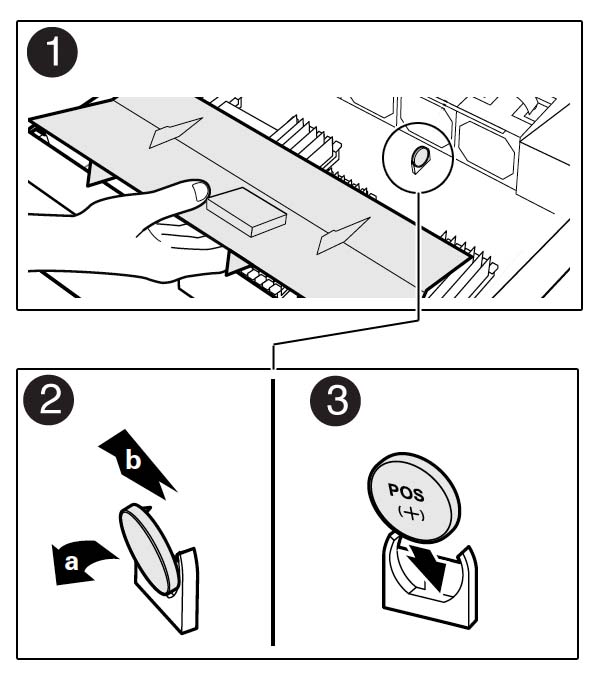

  2. Remove the air duct.
    See Remove the Air Duct.
  3. Tilt the battery slighly to left and lift the battery out of the receptacle.
    image:The illustration shows pressing the release tab.
    The battery pops up.
  4. Lift the battery out of the receptacle.
  5. Set the battery aside.
