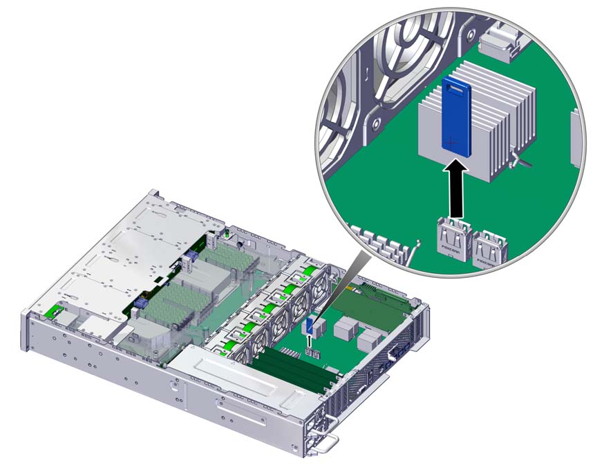

  2. Grasp the USB flash drive and pull it straight up and out of the chassis.
    image:The illustration shows removing the USB flash drive.
